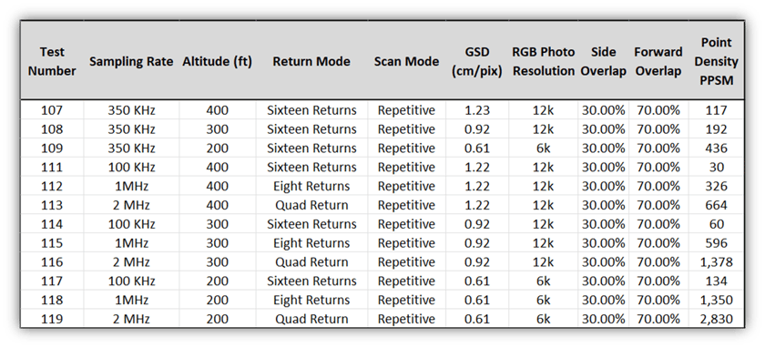

Flight Matrix Table

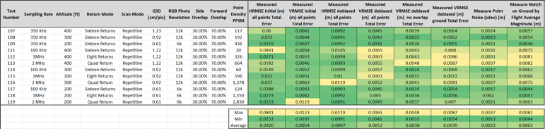

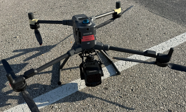

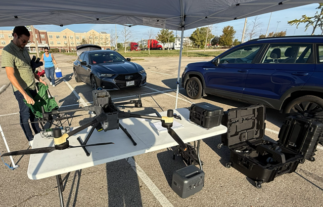

A total of 12 missions were flown at 200, 300, and 400 feet AGL. For each altitude, multiple sampling rates were tested while keeping the linear scan mode consistent across all flights. All missions were flown using the same Matrice M400 and Zenmuse L3, over the same 40-acre test area, with trajectories processed through a consistent PPK correction source. This controlled setup ensured that any differences in the results were driven by flight altitude and sensor settings, not by changes in GNSS processing or equipment.
3-Dec-19-2025-03-44-01-9156-AM

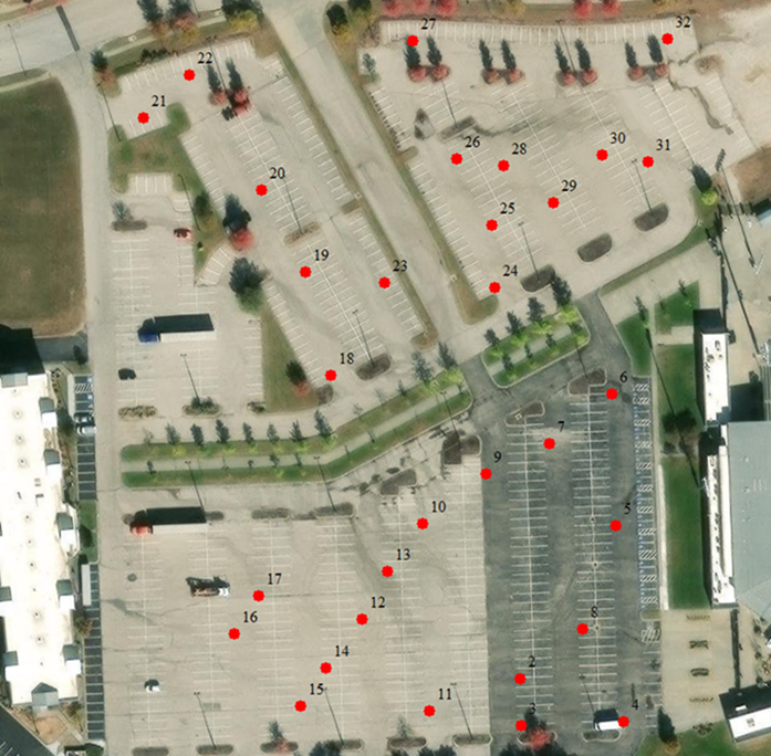

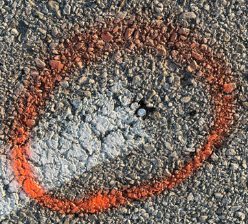

For the check shots: Christian and the team established a network of 30 elevation checkpoints following the ASPRS Positional Accuracy Standards. These points were collected using a Carlson BRx7 GNSS receiver, with each checkpoint measured twice to confirm horizontal repeatability. All measurements were collected over a VRS connection with an approximate 5-mile baseline, and each observation was recorded over 30 epochs to ensure stability. Elevations were further refined using a closed optical leveling loop, achieving ground-truth accuracy within approximately one-thousandth of a foot (0.03 cm).
These 30 checkpoints served exclusively as validation points. No ground control points were used at any stage of the L3 accuracy testing to avoid influencing the system-level error assessment.

Across all 12 flights in the test matrix, the Vertical RMSE (VRMSE) remained within 1.3 cm or 0.51 inches using the L3 point cloud generated in DJI Terra.
After applying a standard vertical debiasing adjustment (a simple uniform vertical shift with no geometric modification), the results tightened even further. VRMSE improved to within 0.7 cm or 0.28 inches across all missions, regardless of altitude or sampling rate. This level of repeatability highlights both the strength of the L3’s internal geometry and the reliability of the M400 platform as a data-capture system.
