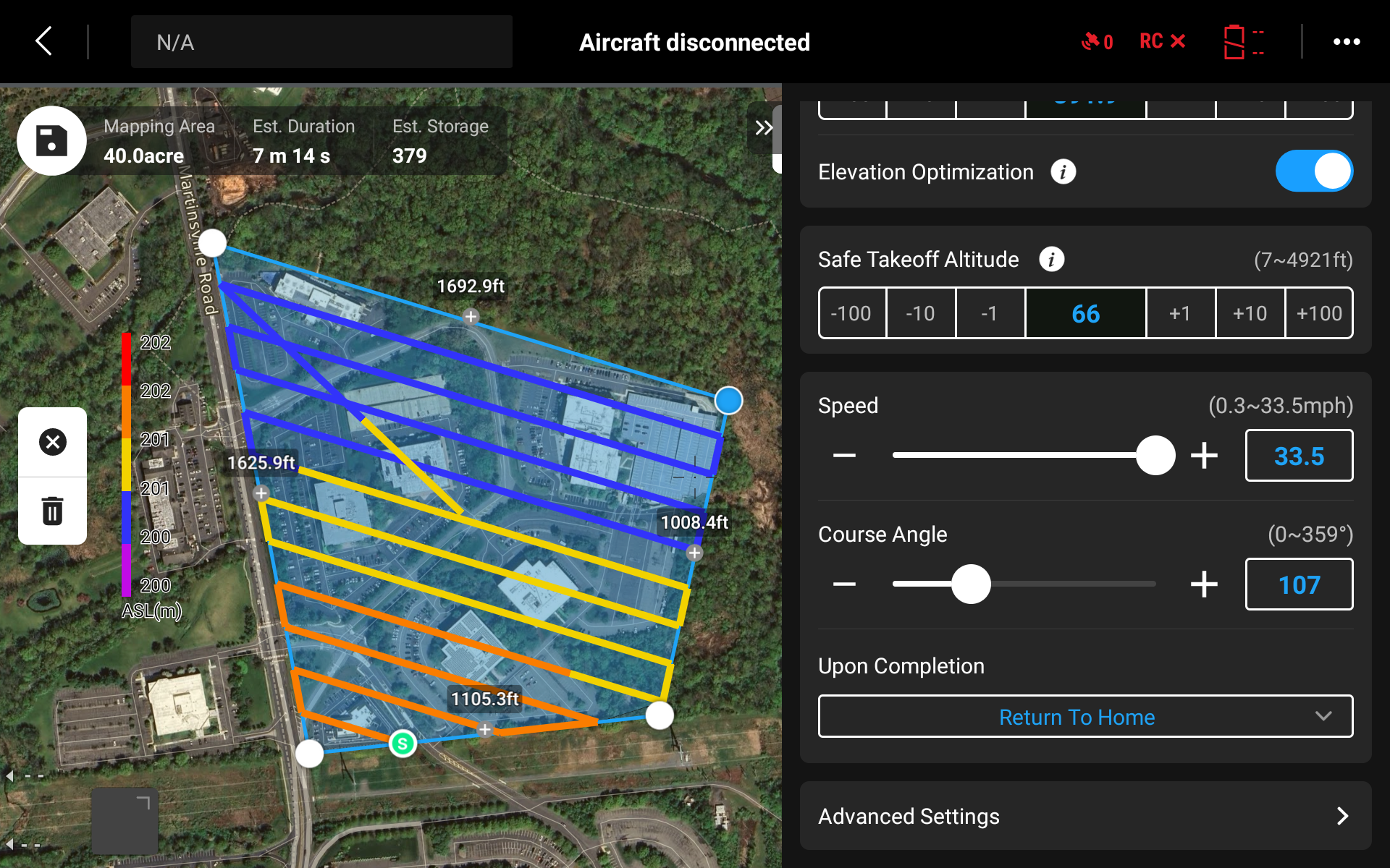

NADIR Flight Plans
For NADIR mapping missions, all three drone systems follow the same flight parameters:
Mission Parameters
  • Ground Sampling Distance (GSD): 1.5 cm
  • Overlap Settings: 70% side overlap, 80% frontal overlap
  • Terrain Following: Applied AsterGDEM
Flight Plan Screenshots:
Mavic 3 Enterprise NADIR Flight Plan
image-Mar-19-2025-11-07-38-0196-PM
Matrice 4 Enterprise NADIR Flight Plan
Matrice 350 RTK + Zenmuse P1 NADIR Flight Plan
System
NADIR Flight Duration
NADIR Photos
Matrice 350 RTK + Zenmuse P1 (35mm)
7 mins 14 secs
379
Matrice 4 Enterprise (24mm)
7 mins 58 secs
856
Mavic 3 Enterprise (24mm)
9 mins 37 secs
739

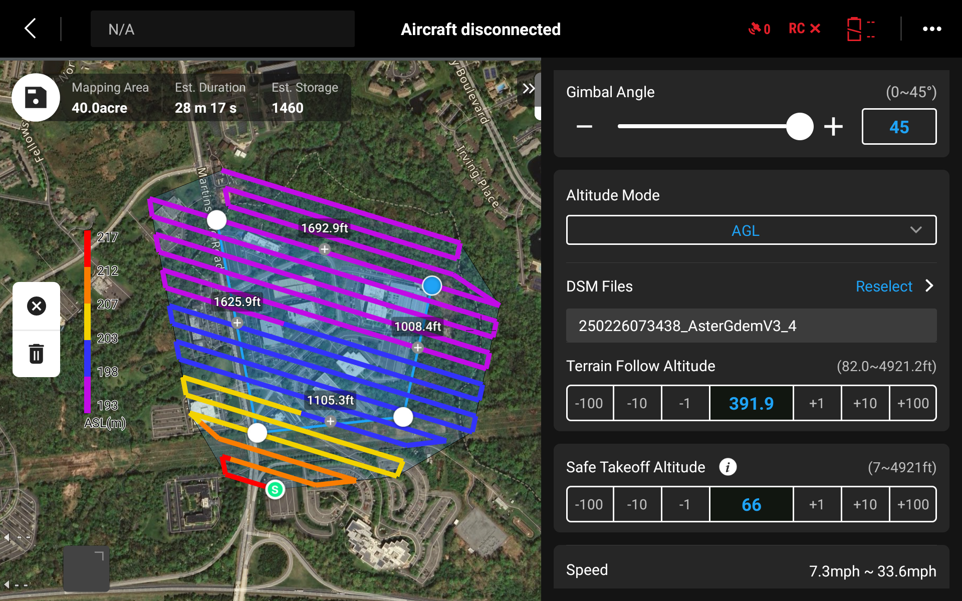

Smart Oblique Flight Plans
DJI Smart Oblique is an automated photogrammetry feature that optimizes oblique image capture by adjusting the camera angles mid-flight, reducing redundant images, and improving 3D model accuracy while saving time and storage. The feature was Initially introduced with the Zenmuse P1, As the Smart Oblique feature is now available on the Matrice 4 Enterprise. This raises an interesting question: Can the M4E achieve the same level of efficiency as the P1 system?
For Smart Oblique missions, the following settings are applied across all three drone systems:
Mission Parameters
  • Orthophoto GSD: 1.5 cm
  • Oblique GSD: 2.12 cm
  • Oblique Camera Angle: 45°
Mavic 3 Enterprise Smart Oblique Flight Plan
Matrice 4 Enterprise Smart Oblique Flight Plan
Matrice 350 RTK + Zenmuse P1 Smart Oblique Flight Plan
System
Smart Oblique Flight Duration
Smart Oblique Photos
28 mins 17 secs
1,460
33 mins 24 secs
3,011
24 mins 11 secs + 18 mins 10 secs = 42 mins 21 secs
1,840 + 1,234 = 3,074
