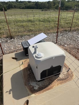

Setting Up the System
Commonly the Dock 3 is installed on a reinforced concrete pad with a dedicated 120 V AC (10 A) power source and satellite internet for connectivity. This setup allowed remote operation in isolated locations where traditional network access is unavailable. It is recommended to elevate the dock to minimize dust.
Screenshot 2025-12-15 at 15.49.29
Key installation items and best practices to consider:
  • Site Selection and Placement: Choose sites with clear flight paths to nearby pipelines and production pads. Position Docks centrally and closer to inspection targets to reduce transit time, maximize coverage per flight, and ensure efficient operations.
  • Performing RF and site surveys to optimize Dock and D-RTK 3 relay station placement.
  • Data Storage and Security: Use on-premise servers or DJI's FlightHub 2 AIO (All In One) deployment if cloud storage isn't possible due to security requirements. For oil & gas networks that often restrict cloud uploads, implement hybrid workflows with local storage and selective sync to maintain compliance while enabling seamless data processing.
  • Integrating FlightHub 2 and ESRI GIS overlays to align inspection routes with buried infrastructure.
  • Maintenance for Harsh Environments: Plan for regular cleaning of air inlets and seal checks to keep the Dock performing reliably in dusty, high-temperature conditions. Establish calibration protocols to account for environmental factors like reflected heat or wet ground, improving data consistency from the start.
These steps ensure that each Dock can operate automatically while meeting strict cybersecurity and maintenance standards.

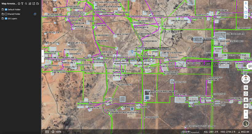

Route Planning in FlightHub 2: Building Reliable, Repeatable Missions
Mission planning in FlightHub 2 is critical to achieving consistent, high-quality inspections across complex oil & gas sites. Unlike simple point-to-point flights, infrastructure inspections often follow irregular pipeline paths, facility clusters, and long linear assets, all of which require precise planning to ensure complete coverage.
Step 1: Importing GIS Layers into Flighthub 2
Oil and Gas companies will import GIS data into Flighthub 2. This is useful for situational awareness and planning missions. The type of data that is important can include pipelines for crude oil (often shown in green), CO2 pipelines or reclaimed water/slurry lines (commonly in purple), wells, processing facilities, storage tanks, transport networks, power lines, access roads, and section boundaries to ensure safe and efficient operations in the field. This data is typically already available and easy to import from a GIS database to Flighthub 2 as a KML or KMZ.
Step 2: Create a Linear or Area Mission Aligned to the Asset
Once the GIS layers are loaded, operators draw the flight path directly on the map by tracing the pipeline, water transfer line, or facility perimeter. For linear assets such as buried produced-water lines or temporary above-ground hoses teams create a Linear Mission by clicking along the line’s centerline to generate a clean, continuous route. This ensures the drone follows the exact path of the infrastructure, enabling consistent, repeatable data capture for leak detection, vegetation loss, erosion, and thermal anomalies.
For facilities, drilling rigs, or pads, operators switch to an Area Mission. They outline the perimeter or key structures, allowing FlightHub 2 to automatically generate a systematic capture pattern for modeling. Panoramas, or general condition checks through waypoint missions can also be done.

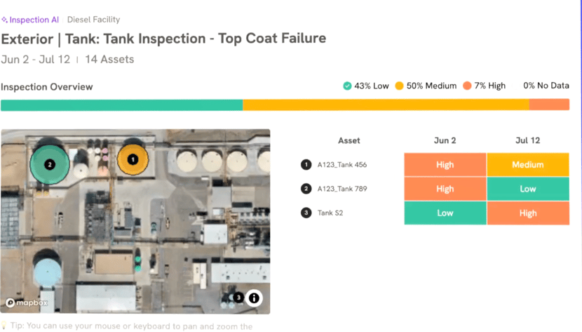

Enhancing Inspections with AI Integrations
Screenshot 2025-12-15 at 15.38.14
In addition to internal AI processing, oil & gas operators are increasingly testing integrations of DJI Dock data with third-party AI platforms to enable advanced analysis and predictive maintenance. Common experiments include uploading drone-captured imagery to AI tools that detect anomalies in real-time and compare against historical data to forecast issues, shifting from reactive to proactive operations.
These integrations typically focus on creating digital representations (often called "visual twins") of assets by overlaying visual and thermal data onto geolocated 3D models. This allows autonomous detection of degradation like corrosion, leaks, or structural weaknesses, with issues prioritized by severity for efficient response. Companies are testing this for assets such as pipelines, storage tanks, and facilities to reduce downtime and prevent failures.
Observed Benefits and Considerations
Operators report that such integrations cut labor hours by automating data review, improve detection accuracy, and facilitate early interventions in high-risk environments. To implement this, start by using FlightHub 2's OpenAPI for custom connections to third-party AI tools, testing small-scale patrols on a single asset before scaling. Consider hybrid on-premises deployments if cloud security is a concern, ensuring alignment with your scalability needs.
Screenshot 2025-12-15 at 15.38.01
How the Integration Works
  1. Data Capture: The Dock launches automated flights to map sites, collecting RGB and thermal imagery.
  2. Upload and Analysis: Imagery is offloaded and imported into the AI platform, where agentic AI processes it without constant human oversight. The system reasons across vast datasets to identify anomalies and trends.
  3. Actionable Insights: Findings are exported directly to asset management systems, triggering work orders and enabling rapid response. This shifts operations from reactive to proactive, reducing downtime and enhancing safety.
Screenshot 2025-12-15 at 15.38.29Observed Benefits and Considerations
This approach complements FlightHub 2's capabilities, allowing teams to choose hybrid solutions that align with their security and scalability needs.

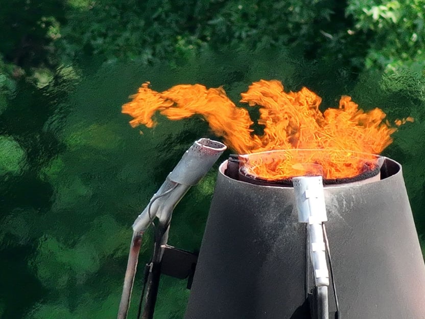

Facility and Flare Stack Inspections
Drones perform visual and thermal scans of production facilities, storage tanks, and flare stacks to detect issues like gas emissions, missing thief hatches, or extinguished flames without exposing workers to heat or hazardous gases.
Flare stack inspection
Inspection of a chemical injection skid used in oil and gas operations to precisely dose chemicals like corrosion inhibitors into pipelines or wellheads for maintenance and flow assurance.
