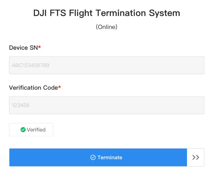

FTS has two activation modes:
- Manual Trigger: Triggered via FlightHub 2.
- Automatic Trigger: Activates if the drone exits the Operation Volume (OV)  due to loss of control.

Step 2: Test Manual FTS Activation
- Power on the drone and Dock 3.
- Confirm the FTS and 4G dongle status in FlightHub 2.
- Go to FlightHub 2 > Device Maintenance > Aircraft Control.
- Select the FTS module, enter the verification code, and slide the Terminate button.
- Verify that the motors stop immediately.
