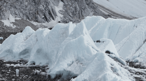

Every year, before a single climber sets foot on Everest, a team of eight to ten Sherpas enters the Khumbu Icefall first. At altitudes between 5,500 and 6,000 meters, they work in thin air with constant exposure to ice collapses, avalanches, and sub-zero temperatures. Their role is to set the ladders, fix the ropes, and establish the route that every subsequent climber will follow. On Everest, they are known as the Icefall Doctors.
The Khumbu Icefall connects Base Camp at 5,364 meters to Camp 1 at 6,500 meters. It is the only passage upward — and one of the most unpredictable environments on earth. The ice moves approximately one meter every day, constantly reshaping itself and creating new hazards without warning. For the icefall doctors, understanding what the icefall looks like — and where it is moving — is not an abstract concern. It is the difference between a safe route and a fatal one.
